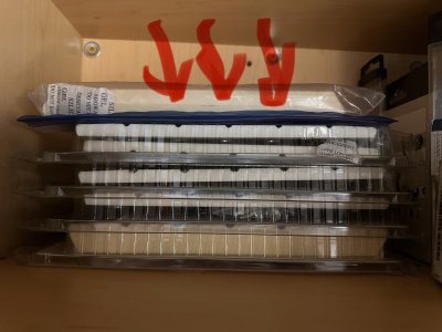

@Cheese @onocoffee @luvmytoolz so my downstairs shop is a mess but this is what I’ve done so far. First you buy H&L sticky sheets that you cut them down to size. Those 10 holes must be punched in order fo dc work correctly, but that’s super easy, they’re all in a line. In another thread about floor mats, @Packard and @onocoffee mentioned the HF relief pads that are 2x2 interlocking squares about 11-12mm thick dense foam. These are perfect and super-cheap. Cut to size, punch holes, H&L on BOTH sides, one for plate, one for paper. I would say it’s medium comparatively to H FT pads. This works awesome, and you don’t have mess around with glues or epoxies or whatever, just make sure you buy the heavy duty hook and loop sheets. Having the H&L tacked to the metal base plate, then velcroed to the foam to the paper, gives you the DC like the oem pads that have the small slits/channels where the dust is pulled up through them. As for punching the holes, @Cheese I know you have leather punches that will go right through, but also if anyone has the kaizen “holer” I think it’s called, that puts perfect holes right through the HF foam tiles. By having that H&L on the metal baseplate to begin with, it leaves it open to basically whatever you can think of and attach it with the Velcro! I haven’t gotten any yet for some reason but mirka and Mafell both make interface paces in that size, although they call it 115x230. So that leaves it open if you can get abranet screens even. They do make it for Mafell’s uva115 sander, but it’s really $$$. I think that the pad that is used on the UVA 115, is almost like the harbor freight foam.
These are the channels/slits I was referencing that are important. This is where the dust goes in. The 2 pieces of H&L together essentially create this space when using your own homemade pad on the RS2.. If you watch this video of mafell’s 1/2 sheet, at the 30 second mark, you’ll see the close up. RS 2 works exactly the same way.
