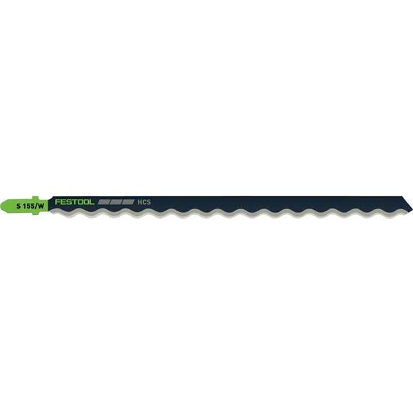

Festool sells a special insulation blade for jig saws:  S 155/W/3
Although I have not have good results with it.
May be better switch to a dedicated insulating saw: ISC 240?

I'm curious what the thickness of the aluminum is and what the thickness of the polyurethane is?
If the aluminum is just a thin veneer then you'd want to choose the blade based on the majority of the material you're cutting.
Bosch makes long blades to cut 4 x 4 material and 6 x 6 material. Need to know the material being cut to decide upon the blade used for the task.
