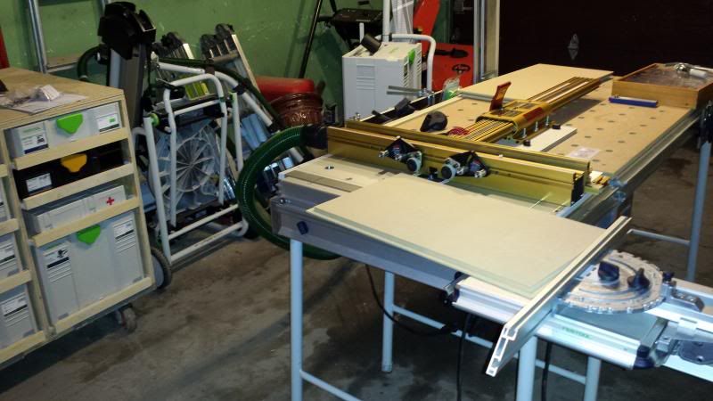

Here is my current setup with my router
I dont use anymore the dual hose that came with the CMS and find that the incra dust extraction port is mutch better than the original festool one.
The only thing that I'm missing is the TS55 CMS insert.. but again it's NAINA  and the only place that I can find to get it is on EBAY and the store is in UK so the pound currency kill me at 1.82 dollard/ pound+ 100£ Shipping. I want it badly but not a 900$ canadian dollards
