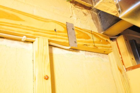

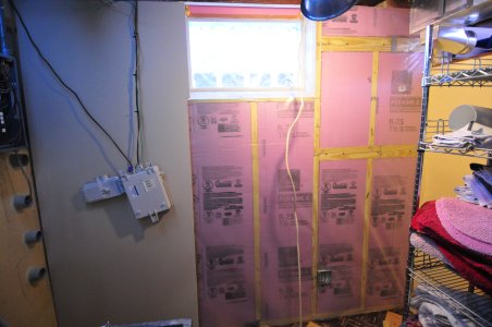

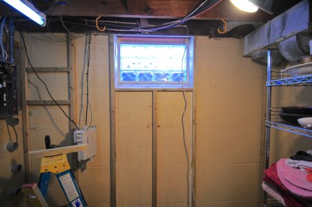

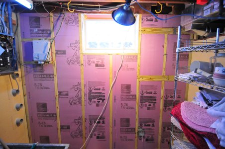

I'd install foam board insulation over the concrete block between 2"x 2" studs and cover it with ply. I did the same thing in the basement shop using drywall instead.
I'd not recommend using OSB as some of the very thin layers of strand board can and will detach themselves when painted with water based paint, I learned my lesson when building the garage. :( It is nice however to mount anything you want to wherever you want without worrying about finding the studs to fasten to.
Photos below:
1. Studs fastened to block with PL400 and powder actuated fasteners.
2. Foam board fastened to block with PL300 using vertical beads of the adhesive.
3. Drywall/ply installed over both and fastened to the studs.
4. Don't forget any electrical cable protection plates.
Photos below:
