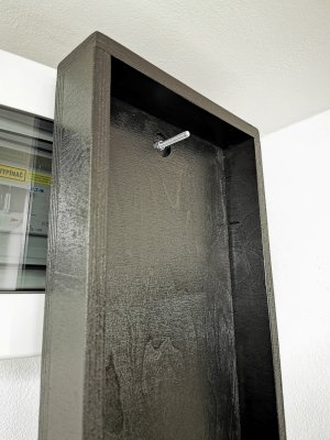

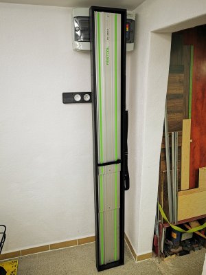

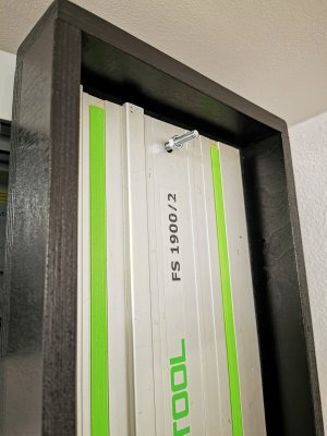

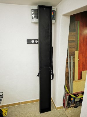

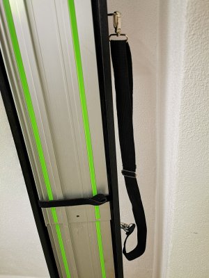

Thank you all for advice. It is priceless. Based on it I made this transportation/storage case

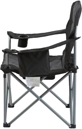

Buying tip: If you want a bag for Festool’s 32” track, consider buying a folding chair. Many come with zip bags, and likely that price of the chair and the bag is less than Festool’s bag alone. This combo is $42.00. It looks like a draw string closure, mine has a full length zipper. Shop around.

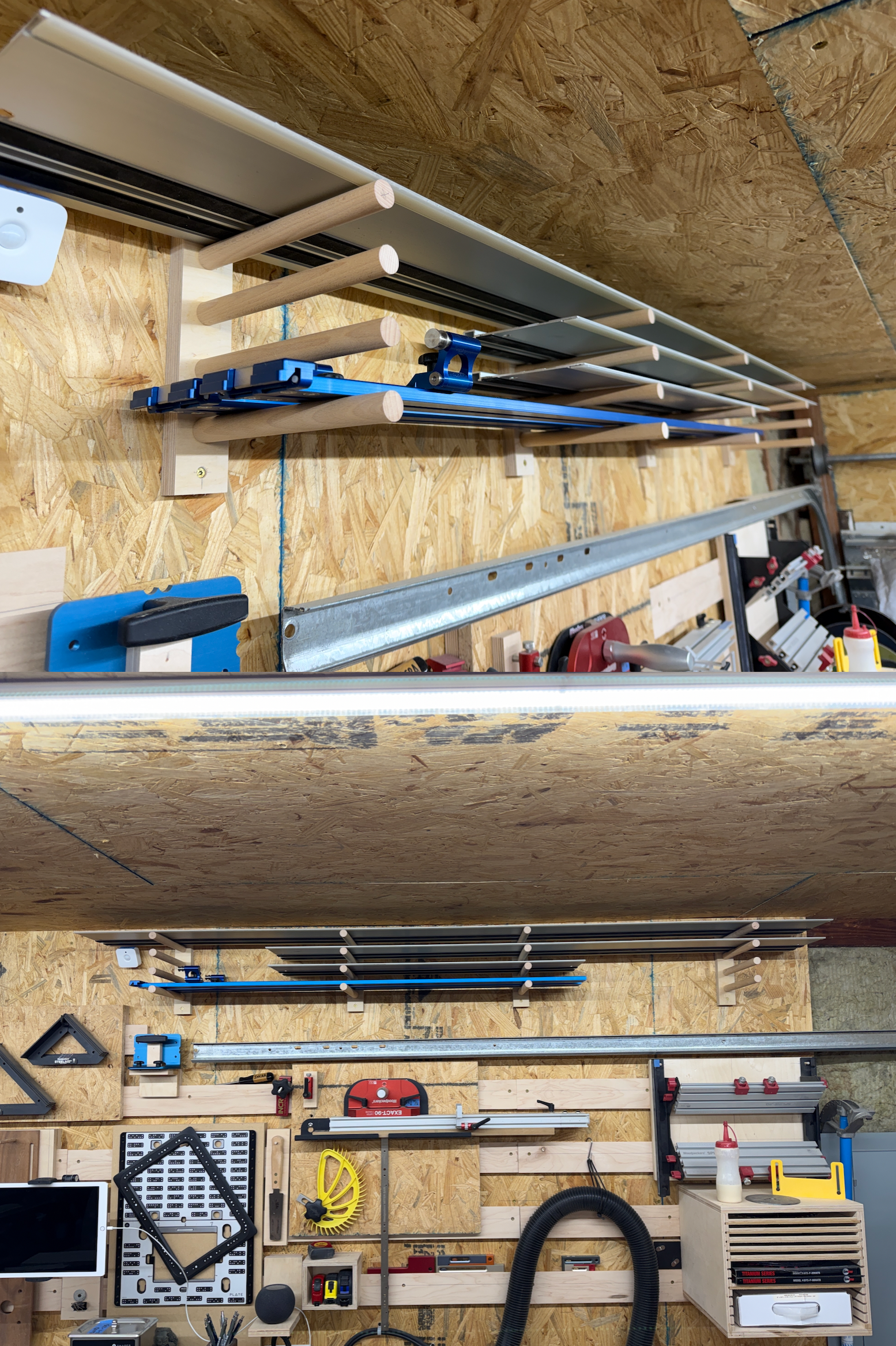

Unless I do a big wall reorg, I'm out of vertical space. I recently opted for the horizontal approach. I dismantled my daughters old IKEA crib and have a bunch of dowels that I used for the racks. I would also like to add a 3000 rail to my quiver and would still need horizontal storage to accommodate it. When that happens, I'll either need to whip together another holder or increase the distance between each rack.
