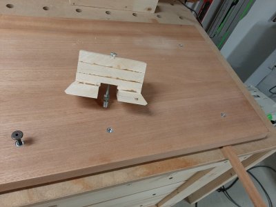

I made a small jig to ensure the insert goes in straight.
You can tell it is made of scrap, but it works. (One day I will make a nice jig)
Some of the Rampa inserts have a 3-start thread, with the idea that it is sitting on 3 points, so tends to go in straight, but I normally use the jig, to guarantee it goes in straight.

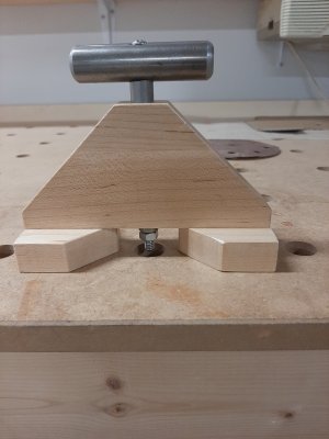

I felt a little embarrassed after posting that, so I made a new, nice insertion tool.
It is open in the center because sometimes the threaded mandrel will break free of the insert when I reverse direction after installation, but often I will need to put an open end wrench in there to break the hex nut free.

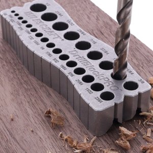

While Big Gator is the acknowledged gold standard in that field, Kreg, Milescraft and others make serviceable versions. My preference is Milescraft. All their fixtures look and feel cheap, but all seem to work perfectly. Walmart sells them for $8.00 online. Milescraft also makes a “Pro” version made entirely out of hardened steel for about $25.00. Any one of those will make perpendicular holes, and will aid in precise placement of the holes.
The video does not explain why they made the jig with a wavy shape. Aesthetics?
Just to be fancy, I should think.
I have the Milescraft with the wavy shape. At the store, they nest together in the display.
I agree, it is probably some marketing thing.
I did google the drill guide and the metal insert is hardened steel. And since it is cast of all one piece, I would expect them all to be square and accurate.

If it was available when I bought my drill block, I probably would have bought the Drill Block Pro. It is probably comparable to the Big Gator. (Still, with the wavy design.)

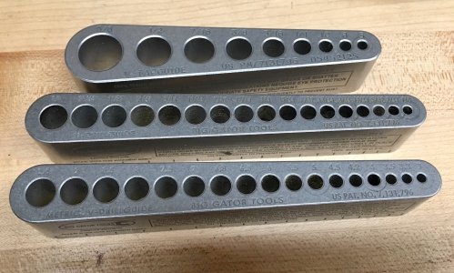

The Big Gator metric (on the bottom) comes in .5mm increments.
