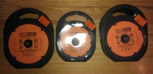

I just got a FedEx tracking notice from CMT. The only thing they owe me is these fiber cement blades for the TS 55 & TS 75 so I think that means they shipped today. If that's correct, I should be shipping them by mid week. I'll put up web pages for them this weekend to make them easy to buy. I have a list of people that wanted them. Hopefully, they all arrived - there were 3 different blades requested...
They're here...
[attachimg=#1]
I'm sending these out to those who asked for them first and whatever is left over will go into stock.
