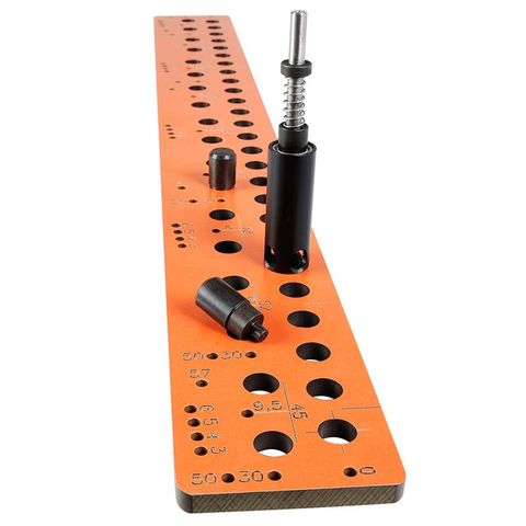

I have the CMT Boring template, a versatile template for 32mm on center holes. It is setup for use either for 8mm dowels or for drilling shelf holes on 32mm centers. It will also drill holes for Blum hinges. I got mine with a dedicated oversized self centering drill guide and bit, but it will work equally well with a 14mm guide bushing and a plunge router.
I could not find a video on the CMT template, but IGM re-brands the CMT unit by changing the color from orange to silver, and has a good video. Watch below.
I would note that CMT has decided not to export this item to the USA. I ordered mine from Amazon.DE (Amazon Germany) which has an English language version and accepts all my Amazon shipping and billing information. You have to toggle to get the translation and after the transaction you have to change your country back to your own. I ordered from Amazon.DE (Germany) but it shipped from Amazon.ESP (Spain). It arrived quickly and I have never regretted the purchase.
