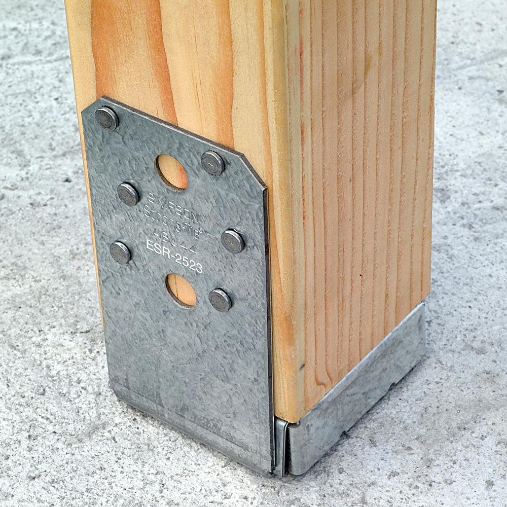

The concrete slab already exists.
I purchased this hardware to mount 4” x 4” pressure treated post 8’ tall.
I also purchased the mounting studs which are 1/2” x 5” hot dip galvanized and are specified for this bracket.
My largest diameter masonry bit is 1/2”.  I drilled to the full depth and tested the fit.  It is a slip fit.
There are no instructions with either the stud or the bracket.  The 1/2” diameter hole does not leave much room for epoxy.
QUESTION # 1:  What diameter hole do I need to use for this application?
QUESTION # 2:  There is a special epoxy that is in a caulking tube. I have only one bolt to set.  Do I need to use that special epoxy?
The post is anchored at the top and will be anchored at the bottom.  The purpose of the stud is to keep things in alignment.

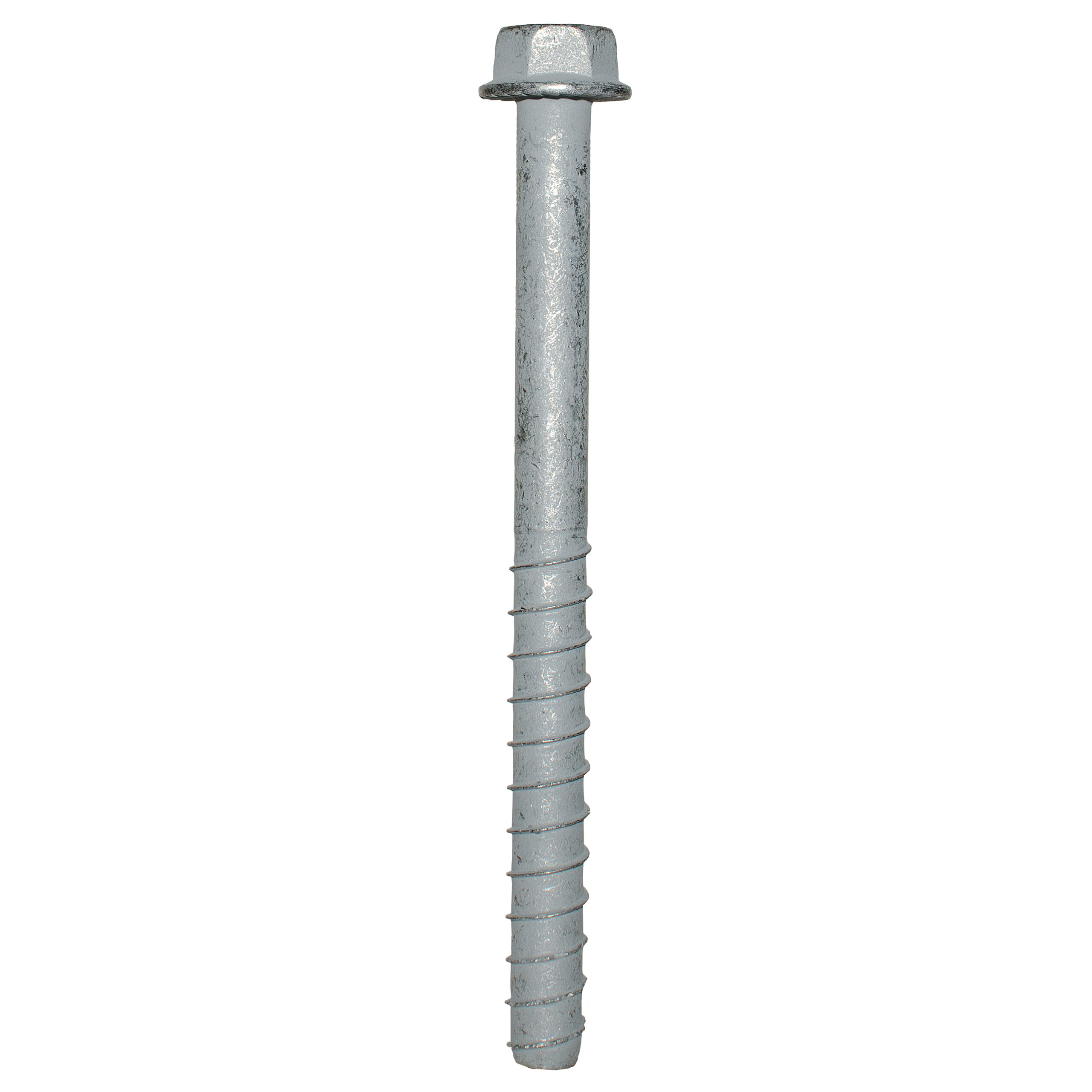

There are of course dozens of solutions for this scenario, and of course it would be helpful to know more information regarding the specific performance needs, but you'd probably be fine with a 1/2" masonry fastener like this:https://www.homedepot.com/p/Simpson...Heavy-Duty-Screw-Anchor-THD50500HF1/300690848

I forgot to mention that the concrete screw I linked is generally best installed with a 1/2" impact wrench, not sure if a normal drill/impact driver would have the oomph. Also, it is generally a "one-and-done", since the steel threads are cutting into the concrete. They are removable, but reusing the screw or hole may not have the same performance characteristics as the first time.
The wedge anchor is generally more user friendly, though you might need to cut the top part of the stud after tightening the nut.
