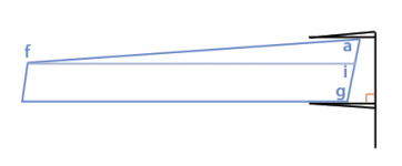

As a follow up to problem with the drawing from the Kapex manual, I included the a pict. The overall shape is the off cut piece with all of the angles, except for the on in the upper right. Instead, I drew a line parallel to the cut made from the saw.
We now have a triangle on the right. The right bottom angle remains 89 degrees. The bottom left angle will be 87 degrees because corresponding angles are always equal. In order to find the top angle, we merely need to subtract 180 - 87 - 89 = 4. 4 is 4 times the actual error.
This solution seems nice because it establishes a relationship between the total error (the base of the triangle) and the angle of that error.
But really it doesn't get us anywhere. Once we measure the error with the calipers, how can we find the error of the angle? We don't have a right triangle, so we can't use trigonometry. We are still stuck with the difference between the top and bottom and nothing else.
In other words, this method does not prove the Kapex manual's formula: Error = 1/4 arcsin [WidthLeft  - WidthRight/Length]

paulhtremblay said:
But really it doesn't get us anywhere. Once we measure the error with the calipers, who can we find the error of the angle? We don't have a right triangle, so we can't use trigonometry. We are still stuck with the difference between the top and bottom and nothing else.
Actually, I'd argue that we do have a right triangle here. Keep in mind that you are not measuring the length of the the ends of the offcut; rather you are measuring its thickness. If you place your calipers with the jaws pointing down the length of the offcut, the calipers themselves will create a right angle, and thus the right triangle.
atomicmike said:
DING DING DING DING!!!! We have a winner!
For all pratical purposes, this is what is happening and is MORE than accurate enough for our purposes.
