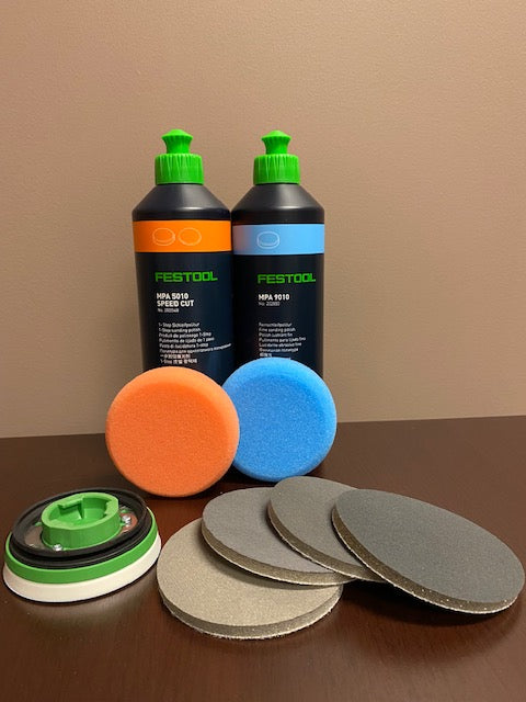

The shields covering the headlights on my eleven year old truck have started to get cloudy and I would like to polish them. Of course, I would like to use the Festool product but that's quite a pricey proposition for the bottles and the pads. Do you have some recommended products to use instead? I have both an RO90 and RO150 to do the job.
Thanks!

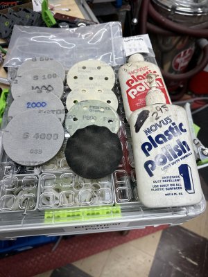

Here's my selection of grits that I use with an RO 90. The only thing I'd do differently is to try applying a final nano or ceramic coating to enhance the long term UV resistance.

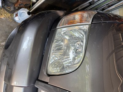

On my 2006 Tundra.
Good stuff
Goofy sideways pics. Oops

There are kits available today, but when I first started doing this, it was just various grits of sandpaper and when I got above 1000 grit, I switched to a foam baked disc. The final polish was with a felt pad, loaded with Novus brand plastic polish. I knew nothing about sealing back then, that's how I know you need to do it more often, if you don't. There are several ceramic sealers out there now.
