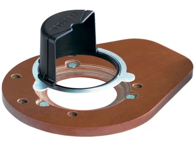

The slick way to do that, would be the one that comes with the Table extender for the OF1400. (493233)
It is larger than the one that comes with the router, and it attaches by magnets. It would give the best, of both worlds.
Then, you would have a quick way to pop on onto an OF1010 too.
Idea, unlocked. Thanks
The 493233 would be real slick to add to any home made router base, I keep one on my 1400. Unfortunately, the only item you need is the swivel cup and that doesn't appear to be available as a spare part. I've checked EKAT before and never found that it was offered as a separate item. Maybe a call to Festool Service would help. The complete 493233 assembly (LAS-OF 1400) is currently $122.

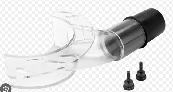

So, these swivel cups rely on having a dust hose mounting on the top of the router's base. What's the comparison to a cup below the base with the dust hose connection built-in?
For instance:
That one is a Bosch branded thing, and it looks like (and reviews read) that the plastic breaks easily, probably just from the dust hose tugging. But, it does seem like it's collection the dust closer to where it's being created, as opposed to trying to suck it up through the base's opening. And those top of the base dust collection fittings interfere with deeper cuts sometimes.
For instance:
It depends entirely on the cut type. The below-base style chip-catcher is best for edge routing, either flush-trimming or profiling. The above-base units just can't pull enough air/dust fast enough for edges. They do a good job, with mortices, grooves, etc (surface work) at least the Festool ones do. I have one, similar to your pic, for my Makita. It's better than nothing, but not great. Fixed-base routers are basically restricted to surface work. IMHO, "tipping in" is not acceptable. People do it....people get hurt, or best case, ruin a part.

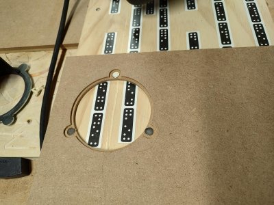

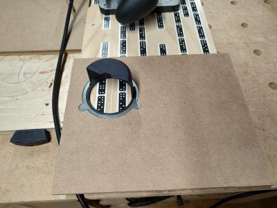

Yeah, I really like that idea. It just came to me, while replying to this thread. I just made that round base a few weeks ago. I could easily add that feature to it. It would be an easy Trace job, or draw it out in Studio, since it is a very simple shape. I've had a stack of 10 x 3mm magnets, in my box, for a few years.

Just a test, in 1/4" MDF, to prove the file.
